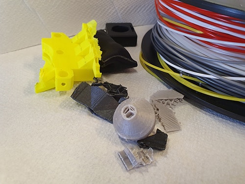

The researchers tested three different PLA samples: a cup, a toy and a 3D-printed material (Figure 1), at three temperatures: 70°C, 90°C and 110°C. With all three samples, they could obtain high selectivities and yields (>94%) of the green solvent despite the different additives, such as colorants, in the items.
PLA Recycling
Figure 1. New catalyzed methanolysis process can turn 3D printer waste into methyl lactate. Source: University of Birmingham School of Chemical Engineering.
