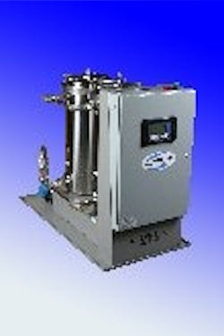

UAS-Kleentek announces the launch of the model N100, its largest-ever oil cleaning and hydraulic equipment improvement system. The N100, along with most of the KLEENTEK systems, will have a NEMA 4 rating, allowing it to be used in extreme outdoor environments.
The KLEENTEK product line is an industry-leading, technologically advanced oil cleaning system that works electrostatically to purge oil of contaminants. KLEENTEK systems are used in the automotive assembly, injection molding, maritime and chemical refining industries, among others.
The N100 was designed for applications requiring large reservoirs, such as paper production, power generation and steel processing. The N100 will have a filtering volume of 10,100 gallons, double the capacity of current systems and will run on standard 115V from a central control board. The N100 provides a flow rate of 5.5 GPM (gallons per minute), double the volume of the previous maximum rate of flow.

KLEENTEK systems use the principles of electrostatics to collect and remove fluid contaminants while eliminating the need for mechanical filters.  KLEENTEK units draw oil from a main reservoir and circulate it at a very low velocity, continually removing contaminants from hydraulic fluids and lubricating oils. These contaminants are trapped on cellulose collector inside a stainless steel chamber where they are collected and easily disposed. Each collector is made of disposable cellular fiber and is specially pleated to hold as much as 10 pounds of contaminants. Depending upon the application, a collector will furnish 2,000 to 10,000 hours of use before a replacement collector is required.
Traditional mechanical filters remove only larger particles, while KLEENTEK electrostatic systems are independent of particle size- allowing submicronic particles (.01 micron and below) as well as large contaminants to be removed from any non-conductive oil. Only insoluble oil contaminants are extracted; soluble additives present in the oil are not affected. Because this system is so effective in maintaining the cleanliness level of oil, KLEENTEK eliminates the need for repeated oil changes and system downtime while operating without supervision.

Additional features standard on the N100:
• A programmable logic controller (PLC) that allows the system to be tied into customer's existing systems, such as an Ethernet.
• Stainless steel tanks for superior corrosion resistance.
• Ease of installation. As with all KLEENTEK systems, installation is simple because of the single inlet and discharge utilizing ¾” NPT.
