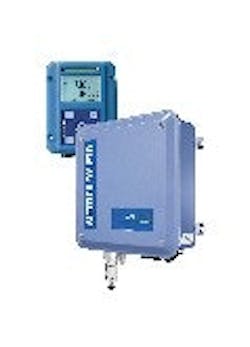

Mettler-Toledo Ingold introduces the most advanced system for fully automated pH sensor maintenance, the EasyClean 400.  Approved for use in hazardous classified areas, the system finds application throughout chemical, bio/pharmaceutical, and food and beverage industries.
The premier member of the EasyClean family of automated pH electrode cleaning and calibration systems offers both pre-programmed and user-configured programs offering the utmost flexibility tailored to application needs.  Also, enhanced diagnostics monitor system conditions to assure optimal operation and safety.  Configuration and control is performed via the Mettler Toledo advanced M700 transmitter.  Profibus digital communications further expands system integration.
