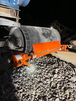

A new conveyor belt cleaner from Martin Engineering holds the urethane blade in place without the need to mill any slots for holding pins. Combining the benefits of previous designs into one product, the QC1+ Belt Cleaner from Martin Engineering can be cut to length to fit virtually any application, reducing the need for customers to stock multiple blade sizes to accommodate different belt widths. Operators simply trim the blade to the desired size from the stock 9-foot (2.74 meter) length to match the material path, slide in the blade holders and lock them in position. The new blade can be retrofitted to virtually any Martin main frame and most competing designs.
The mainframes on the QC1+ are 3-piece assemblies, with a square center section and a torque tube sliding into each end. The tubes are formed from high-strength steel and engage in the corners of the square main frame. They transmit the torque from the tensioner through the tubes and into the main frame to maintain blade tension.
The torque tube lock collars are designed to be an interference fit with the square mainframe. To assemble, the tube is installed first, then the collars are added and set in position. The length of the mainframe is adjusted next, and finally the set screws on the collars are tightened down. In most applications, the simple sequence can be performed by a single worker in just a few minutes. The new design is compatible with any of the Martin tensioning systems.
Urethane belt cleaner blades from Martin Engineering are designed with the company’s patented Constant-Area Radial Pressure (CARP) technology to deliver consistent cleaning throughout all stages of blade life. The cleaners maintain the same contact area, blade angle and pressure to effectively remove virtually any type of material carryback, even as the blade wears down over time.
