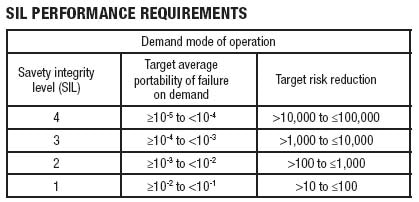

Safety system standards are performance based, not prescriptive. Essentially, the greater the level of process risk, the better the safety system needs to be to control it. Standards don’t mandate such things as technologies or manual test intervals. They do, however, specify the performance requirements. A variety of techniques may be used to come up with the required SIL. Table 1 lists the performance requirements for the four integrity levels defined in the standards.
Table 1. Each step up in SIL mandates at least an order-of-magnitude improvement in performance.
