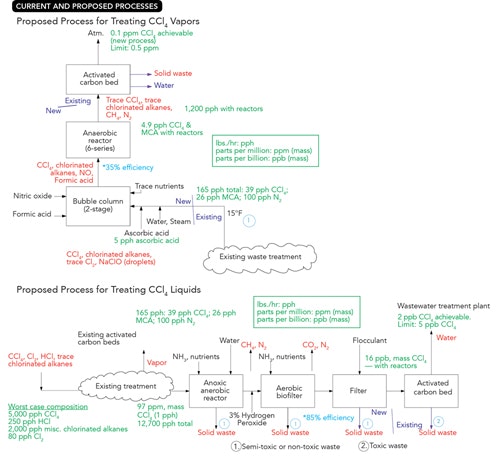

The byproducts from our chlorination process are carbon tetrachloride and hydrochloric acid. We’re desperately trying to eliminate the CCl4 because we’re frequently tagged with air and water emission fines. During process upsets, which can last for up to a day, as well as startups and shutdowns, we send up to ten times our normal output of CCl4 and miscellaneous chlorinated alkanes to our treatment system. This is more than our activated carbon beds (ACBs) can tolerate. We use a group of ACBs for vapor removal and another set for liquid removal. We are following the EPA’s best engineering practices: “a granular activated carbon bed (ACB) followed by packed bed aeration.” The EPA allows a maximum contamination level of 5 ppb for water and 0.5 ppm for air. The “reportable quantity” for CCl4 is 10 lb/year. Our current process (see “existing” on Figure 1) involves four steps: 1) caustic scrubbing; 2) decanting; 3) washing/filtering; and 4) condensing the vapor. We have limited space on site because we’re located near a highway but we own several acres within 200 yards of the plant. A contractor has come up with an alternative design to avoid some of the solid waste created by the ACBs: an anaerobic reactor and aerobic biofilter for the liquid and a bubble column followed by an anaerobic reactor for the vapor (see “proposed” on Figure 1). What do you think of this idea? Can you suggest any other alternative unit operations that could effectively eliminate our outflows to sewer and air? What can we do about the air emissions from our distillation column? Our plant manager says just pay the fines and ignore the problem.

Figure 1. Existing treatment system gets overloaded during upsets as well as startups and shutdowns.
