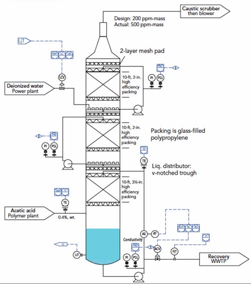

We were contracted to design and install a water scrubber for acetic acid to allow our client to expand its reactor building (Figure 1). The acetic acid is a byproduct of an acrylic acid process. The scrubber was installed a few weeks ago. The expanded plant just started up two days ago. Unfortunately, it isn’t meeting the emission target. I was sent to investigate.
The scrubber consists of three equal 10-ft beds of high-efficiency random packing. Each bed has a two-ply mist eliminator; v-notch troughs distribute the liquid. Three separate pumps ensure even distribution in each bed.
An initial sampling of the reactor vents shows about 10% dust by weight. This was not anticipated. Also, the pH is much lower than expected from the data sheet provided for our calculations.
On inspection, I found the bottom packing is larger than that specified in the design calculations and the scrubber packing doesn’t match what we used in those calculations. In addition, the packing I sampled from the spare fill material isn’t a uniform material but appears to be broken and off-brand; spare fill is added after the beds settle. After only two days of operation, the blower speed is nearing 100% and the temperature of the scrubber basin is higher than design.
What are our options for improving efficiency, avoiding a melt down of the packing and pleasing our customer?
Vent Scrubber
Figure 1. Unit is not providing expected acetic-acid removal efficiency.
