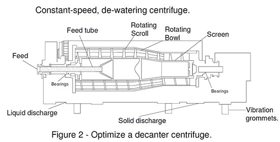

De-Watering Centrifuge
Figure 1. A number of problems afflict currently installed units.
February’s Puzzler
Our constant-speed continuous decanter centrifuges (Figure 1) aren’t doing a good job in separating corn starch from water. In truth, these units never have worked well but we could get by because our process has some redundancy. Now, due to a six-sigma initiative, I’ve been asked to optimize centrifuge operations. My investigation has found a variety of problems, including: variations in feed-stream concentration — the flow rate changes only slightly; bearing failure because crystals get past the shaft seals — we added a hot-water/steam flush of the scroll to eliminate this problem but we now get scroll vibration; some corrosion attack is starting at welds where the stainless steel has gone to rust — this mainly appears on the outside of the feed tube but we also see attacks in the screen and, now, even the scroll; seal failure has become a monthly affair because of shaft corrosion; a likely increase in the risk of fire from solid buildup behind the seals; and surging at the solids discharge lip and swamping at the water discharge.
Maintenance is pushing to replace the centrifuges because they cost $2.2 million/year to maintain. Projects says swapping them with new dual-drive or hydraulically driven centrifuges to handle the variations in solids loading and flowrate would eliminate this cost. However, an electrician brought in to assess the over-taxing of the electrical system warns these new drives would affect the starting and stopping loads on our grid. Operations prefers the existing setup because of its familiarity.
What do you think? Are these units worth saving? Is there anything else we should consider?
