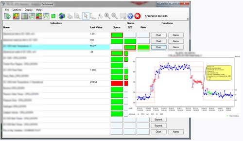

So, in the spring of 2012, Dow turned to NWA Focus EMI from Northwest Analytics, Portland, Ore. It allows Dow to access data directly from existing data sources, passes these data through a global analytics layer, and then visualizes the critical process information in real time (Figure 1). This enables us to gain the information needed to monitor, understand and control our manufacturing processes. “Dashboards are shared across departments. When behaviors are contrary to agreed-upon metrics, the decision becomes data-driven,” notes Mary-Beth Seasholtz, one of our senior data scientists.

Figure 1. Dashboard summarizes key process information and provides easy access to underlying data.
The global analytics layer turns the vast amounts of data into information and metrics anyone could use. Everyone requiring the information locked within the data gets it in real time in the proper context for the person’s particular job and for taking action if needed.
