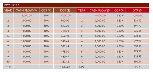

Table 1 illustrates simplified examples of three projects. All three use a basis that all funds are expended or received at the start of the year. Table 1 includes the year, cash flow, COF, discounted cash flow (DCF) and total NPV.
• Project 1 has a high NPV and a low IRR.
• Project 2 has a low NPV and high IRR.
• Project 3 is shown with only an NPV.
This looks confusing? Which would be the better project to invest in?

Projects' Economics
Table 1. Project 1 offers a higher net present value (NPV) but Project 2 provides a higher internal rate of return (IRR).
Simplified methods to calculate NPV and IRR are available. Such simplified methods often assume a fixed outflow amount followed by a constant inflow of funds for a fixed period of time. These simplified methods may give nonsense answers for complicated cash flows. Additionally, some IRR formulas assume cash generated by a project will be reinvested at the IRR. Others assume net cash generated will be reinvested at a different COF rate. With complicated cash flows, even the meaning of IRR becomes ambiguous. For this reason, no IRR was included for Project 3.
