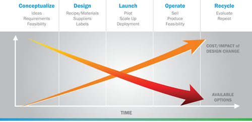

Compliance Through The Product Lifecycle
Figure 1. Options decrease while the cost of changes increases as a product moves through its lifecycle.
Let’s take a look at key issues during the product lifecycle and how product compliance can become part of the overall product sustainability process.
1. Concept and design. Here, a company must identify constraints on a global regulatory basis and for each intended use. Product compliance at this stage helps an organization avoid costly last-minute product reformulation or repackaging by understanding the regulatory business risks associated with material composition based on the intended use. This also is the time that the firm should create a detailed plan for disposal at the end of the product’s lifecycle.
