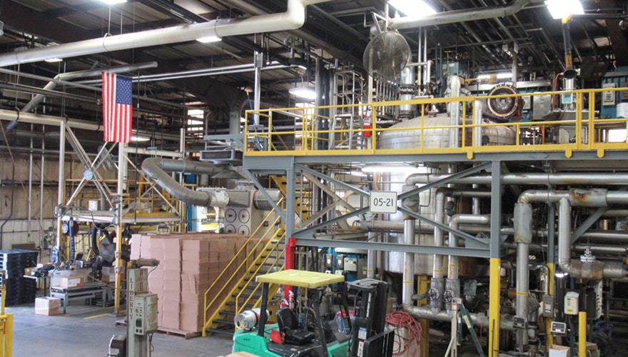

Figure 1. Mike Ritter, lead operator on the effort, was impressed by the method and its results — a more than doubling of capacity.
Mike Ritter (shown in Figure 1), who was lead operator on the adhesion-promoter project, raved: “I have seen every program in the last 30 years. This is completely different. This was built with us — the local work force — from day one. It started with us. Our ideas were the foundation. We tested our ideas in our world, not some simulation or computer program. Everything we tested was practical, fast, cost-free and safe. We, the operators, calculated the results. We saw what worked and what didn’t. Our ideas cut cycle time in half and improved quality at the same time, and we don’t work any harder.”
