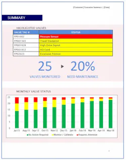

Remote Review
Figure 4. Outside experts can monitor valve diagnostic data and highlight developing problems as well as serious issues demanding immediate attention.
After developing the list of valves needing overhaul, the next step for the STO team is to carefully evaluate those valves to determine the best method of repair. For valves just requiring a simple repair, the solution often is obvious and necessary replacement parts can be ordered. Other valves may offer upgrade opportunities that may make better financial sense.
For instance, a valve may have a history of trim failures related to difficult process conditions. A trim upgrade or even a completely different valve design may provide compelling advantages over simply replacing a part. It may be cost effective to install digital positioners on critical valves to enable partial-stroke testing. Such online testing may allow the plant to extend time between maintenance events, saving significant sums.
Another option worthy of consideration for some valves is using repair assemblies offered by original equipment manufacturers (OEMs) rather than single components. For instance, for some Fisher valves, a drop-in trim cartridge replaces up to 20 individual components. Such assemblies minimize the technician training necessary for installation and may make inline valve repair possible, saving time and resources. They also can reduce the cost and number of spare parts that a plant must keep in stock.
When evaluating these options, it often is wise to take advantage of a valve vendor’s expertise; a vendor usually can provide a list of alternatives while providing cost comparisons to determine the best solution.
