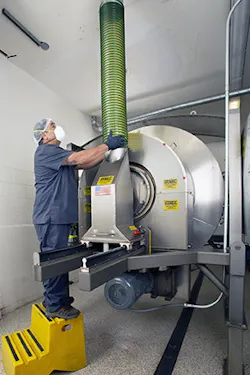

A hammer mill reduces materials to the desired particle size. They then are transported in 44-gal (194-l) lined food-handling containers to the gravity-fed rotary batch mixer, a 40-ft3 (1,132-l) model 700-TS-40-SS from Munson Machinery (Figure 1).

Figure 1. Unit blends ingredients in batches that range from 100 lb to 1,147 lb.
At the conclusion of a blending cycle, the drum continues to rotate, causing the internal flights to elevate the material toward and through a plug gate valve; this avoids stratification associated with discharging of static batches. “The mixer completely discharges,” says Hansen, eliminating material waste and reducing cleaning time.
