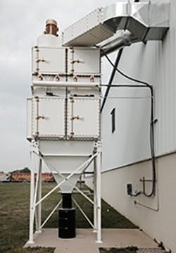

Dry Dust Collector
Figure 1. Positioning the collector in a location removed from the work area often makes sense.

One of the best options for keeping hazardous dusts away from personnel is a dust collection system with high-efficiency primary and secondary cartridge-style filters. It’s preferable to capture chemical fumes and dust at their source — by incorporating a hood or extraction arm into the process machinery — to prevent them from expanding throughout the plant. Source capture is extremely effective and requires the least energy and capital investment.
You should isolate the captured dust from the rest of the facility and contain it in a specific area (ideally one kept under negative pressure). Send the extracted air either directly into a local collector or, via ducts, to a collector located remotely (Figure 1). In some cases with proper HEPA filtration, you can safely return the filtered air back into the facility to create a push/pull airflow pattern to improve contaminant control.

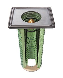

Enhanced Filter Media
Figure 2. Top layer of nanofibers improves dust release during cleaning and lowers pressure drop.
High-efficiency dust collection systems also use self-cleaning mechanisms that regularly pulse dust off the filters, allowing units to run longer between filter change-outs. Applying a layer of nanofibers on top of the base filter media promotes surface loading of fine dust and prevents the dust from penetrating deeply into the filter’s base media. This translates into better dust release during cleaning cycles and lower pressure drop readings through the life of the filter.
