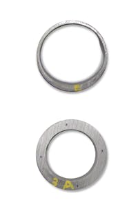

It now is known that AVT(R) chemistry will induce flow-accelerated corrosion (FAC) in feedwater systems; this can cause wall thinning (Figure 2) and ultimately lead to catastrophic failures. In the last 30 years, several FAC-induced failures in the U.S. have resulted in fatalities.
Wall Thinning
Fig. 2. Single-phase FAC caused the substantial wall thinning shown. Source: ChemTreat.
In brief, when steam generators go into service, the carbon steel develops a thin layer of magnetite, Fe3O4. The combination of a flow disturbance and the reducing environment causes iron ions to leach out of the steel/magnetite matrix, resulting in the wall thinning. Temperature and pH affect the extent of the dissolution; it usually reaches a peak at a temperature of about 150°C and increases with lower pH (e.g., 9 and below).
