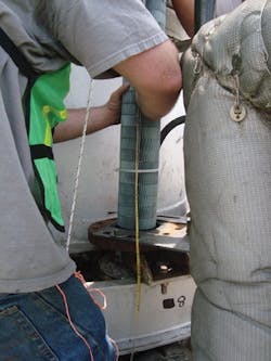

CATALYST INSTALLATION
Figure 2. Special tool eased insertion of 3-ft-long catalyst sections into reformer tubes.The plant's staff, with Catacel supervision, completed the catalyst changeout to SSR in two days in May 2012. The installation involved 72 3-ft-long sections of structured foil catalyst, comprising a total of nearly 2,000 SSR fans. Each section was inserted into the reformer tubes with a special Catacel-designed tool and, once in place, was expanded to conform to the specific geometry of each tube (Figure 2). SUBSTANTIAL SAVINGS"Our data log for the first three months of operation with the new SSR catalyst indicated burner fuel consumption decreases of up to 30% compared to the consumption data logged for the same plant rates when our plant was charged with traditional ceramic pellet supported catalyst," notes Fontana. Table 1 provides details.
