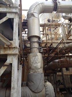

Non-intrusive Meter
Figure 1. Ultrasonic unit provides concentration and corrected mass-flow data. Source: Flexim.
The sulfuric acid is made on site from molten sulfur and water. It's critical to carefully monitor both acid flow and concentration. We were using temperature-compensated conductivity meters, also called titrimeters, on a slipstream of acid from the main recirculation flow to measure concentration. These meters provide accurate information when they're working properly — but they're intrusive, coming in direct contact with hot sulfuric acid, and frequently failed, resulting in leaks. These leaks, rather than the instrument failures, were our biggest concern because of their safety and environmental impacts.
Eliminating or at least decreasing how often we have to send flow through these smaller lines would substantially reduce the risk of leaks.
About two and a half years ago, I mentioned the problem to the account executive from Solares Controls, a manufacturer's representative and distributor that we'd been working with for years. He recommended ultrasonic meters. We already had installed several ultrasonic units from Flexim on our water and gypsum lines strictly to measure flow and were pleased with their accuracy. He told me Flexim also made a meter, called the PIOX S, that measured concentration and temperature as well as flow. Because ultrasonic meters are non-intrusive, I was immediately interested.

I decided to take the cautious route — installing one meter and monitoring its accuracy for a year. It proved satisfactory, prompting me to think we could eliminate most of our leak problems by getting concentration readings on the main acid lines. I ordered a second meter for a second line. After that worked out well, I decided to put the meters on all of our interpass acid lines. We now have 20 Flexim PIOX ultrasound meters performing well and sending data back in real time. They have improved safety, accuracy and production.
I'm pleased at how non-intrusive metering makes my job easier and the plant more efficient by reducing downtime. Before, we couldn't repair acid leaks on the run because we couldn't operate without a concentration meter. Now, even if we only use the ultrasound as a backup to measure concentration, we can make the repairs without having to shut down.
Many of the ultrasound meters back up our titrimeters but a few serve as primary measurement devices. As they continue to prove their value I plan to phase them in as primaries to eliminate intrusive metering.
