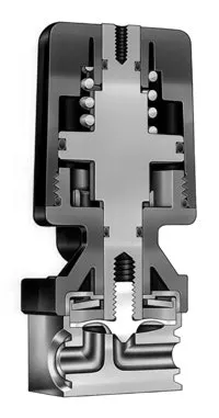

Diaphragm Valve
Figure 2. Benefits include rapid shutoff, precise actuation speeds and unrivalled cycle life.

Unlike packed valves, diaphragm valves (Figure 2) are packless. They provide rapid shutoff and precise actuation speeds and, in some cases, also may deliver consistent quantities of process fluid. Diaphragm valves typically are employed in high purity applications. They offer the highest cycle life of any valve type, thanks their highly engineered anatomy. Each valve contains a thin metal or plastic diaphragm that flexes up and down, creating a leak-tight seal over the inlet. This robust valve usually is small, with the largest orifice or internal pathway typically less than 2 in.

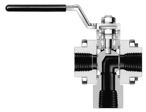

Some ball and diaphragm valves are designed with multiple ports. In most multi-port valves (Figure 5) fluid enters through a single inlet but may exit through one of several outlets, depending on the position of the actuator. Multi-port valves may or may not have a shutoff position.

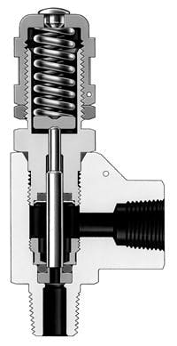

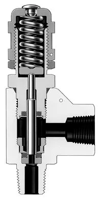

One type of relief valve is a proportional relief valve (Figure 6). It contains a vent to atmosphere that opens when system pressure exceeds a set point. A spring-loaded poppet enables the measured release of fluid. The vent closes when pressure returns to a point below the set point.
A safety relief valve is designed to open very quickly, releasing a large amount of system media. Safety codes require use of such valves in certain applications.
Don't use safety relief and proportional relief valves interchangeably with check valves -- the three serve different functions.

Proportional Relief Valve Figure 6. When actuated by
over-pressurization, this valve provides a measured
release of fluid.
