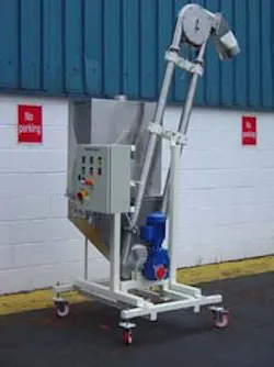

The system designed and custom built by Spiroflow consists of a stainless steel conveyor and a distribution system comprised of an inclined 90-in.-long straight-line conveyor with a sack tip hopper at the inlet. The system is mounted on a mobile frame complete with two fixed and two swivel casters. The casters ensure easy positioning and have locking brakes for maximum safety.
When material must be added to the mixer, the mobile conveyor is positioned onto a 4 ft. × 4 ft. weight platform whose top is flush with the factory floor. Then the weight of the conveyor is tared so that the precise amount of acrylic powder can be loaded into the conveyor feed hopper. The powder is tipped into the hopper through a plastic strip curtain located at the front of the dust hood above it. The hood is connected to a dust extraction system that ensures environmentally safe dust-free operation. A grid across the top of the hopper breaks up any agglomerates, a main concern with the previous procedure. A rotary valve controls the rate of flow from the hopper to the conveyor. Six air-operated vibratory pads strategically placed around the hopper ensure a consistent flow of powder into the rotary valve at the hopper outlet without bridging.
The conveyor has 3-in. conveying tubes and operates at a 45-degree angle. An air motor powers both the conveyor and rotary valve as is common in hazardous environments. An inner-locked access panel facilitates cleaning of the internal conveyor components and a vision panel in one of the conveying tubes enables operators to determine when cleaning is required. Because the unit is self-emptying, cleaning only is necessary if there's a build-up of a sticky or cohesive product or to avoid cross-contamination between batches.
The conveyor systems consist of several evenly spaced polyurethane disks attached to a wire rope. The rope and disks travel in a continuous loop within parallel steel tubes. At each end, the rope assembly runs from one tube to the other around specially designed sprockets. One of the sprockets drives the rope and disks while the other provides tension to the rope. By maintaining the rope and disk assembly at a constant high speed, the conveyor produces an air stream that fluidizes and conveys product to the mixing vessel where the powder is centrifugally ejected. This method of conveying action allows production capacity to be ramped up or down with low energy requirements and minimal product degradation and separation.
