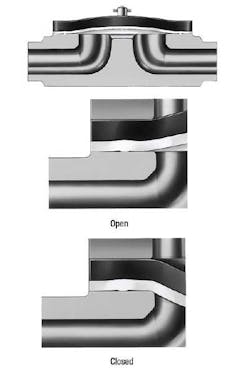

Carefully consider valve selection. For instance, in critical shut-off applications, the most common options are weir-style and radial diaphragm valves. The weir-style valve offers a proven track record of solid performance in validated systems. Yet its sealing design can leave some opportunity for entrapment or contamination. The diaphragm is designed to seal on a sealing bead outside the weir area. However, in the open position, the diaphragm lifts up and flexes, exposing the valve body along the perimeter of the bowl (Figure 2).
Figure 2. Fluids may become trapped between the diaphragm and the valve when the diaphragm closes.
As the valve closes, the diaphragm closes back toward the body of the valve, trapping small quantities of fluid.
Newer radial diaphragm valve designs avoid such problems because the diaphragm seals along the edge of the valve’s bowl. At no time does the diaphragm lift beyond the edge of the bowl. As a result, entrapment doesn’t occur. Further, bowl shape, inlets and outlets are configured to ensure that the flow path is cleanly swept and optimized for full drainability. Not surprisingly, such valves are seeing increasing usage.

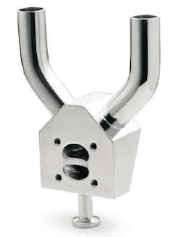

Figure 6. This alternative to a point-of-use valve with a static tee assures full drainability.
The distance between the two vertical drops coincides with ASME-BPE recommended dimensions for “U” drops. Weir-style or radial diaphragm valves may be employed in Viking formations.
