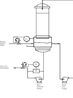

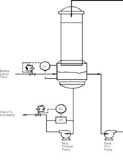

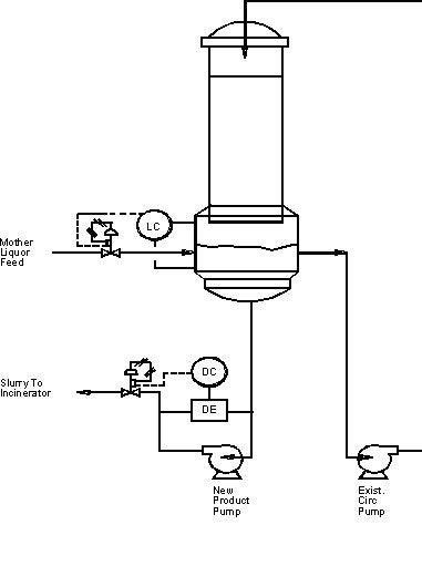

First of all, I’m not sure of the reasoning behind using a falling film evaporator to concentrate a mother liquor solution from a crystallizer. With the mother liquor being saturated, any increase in concentration by evaporation will result in crystal (solids) formation.
1. Why not send the mother liquor back to the crystallizer rather than the falling film evaporator?
2. If the mother liquor cannot be sent back to the crystallizer and must be processed by the evaporator, then go to continuous operation and add a “product pump” with density control loop and modify the suction piping for the recirculation pump per Figure 1. With the rapid solids settling rate, the new product pump will discharge the slurry to the incinerator, and the recirculation pump will handle “clarified” solution.
3. It is possible that fouling in the heat exchanger is a result of plugging of the distribution plate (if a drilled perforated plate is used). If so, I recommend replacement with a shower-spray-nozzle distributor.
4. With an increase in production requirements, I recommend addition of a submerged-tube forced circulation finisher to operate in parallel in terms of vapor flow and series in terms of liquid flow. The solids concentration in the falling film would be reduced and the product concentration solution would be delivered by the forced circulation effect.
Joseph T. Badyrka, president
