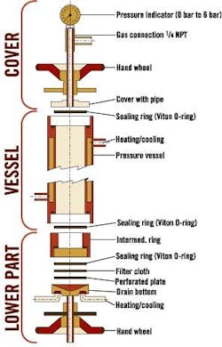

Bench-top testing first must be used to narrow the gap between theory and practice and to begin the equipment selection process. A useful bench-top filter system is a pressurized pocket-leaf filter (PLF), which resembles a Buchner funnel. The figure shown on the next page illustrates a typical PLF unit.
The PLF shown has a filter area of 0.002 square meters (sq m) and consists of a pressure vessel (90 pounds per square inch [psig] to full vacuum), a top cover with a pressure gauge and gas (or air) connection and a bottom base for the filter media and filtrate outlet. The pressure vessel and base are jacketed and can be heated or cooled with a heat-transfer medium. The filter media can be synthetic single-layer metal or multi-layer sintered metal. The materials of construction are 316 Ti stainless steel, Hastelloy or polypropylene, and the fill volumes range from 250 milliliters (ml) to 2,000 ml.

PLF Unit
Source: BHS-Filtration Inc.

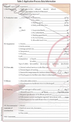

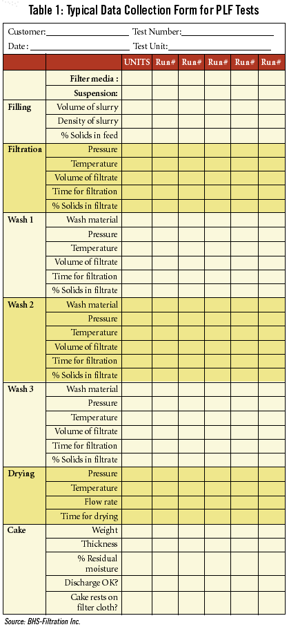

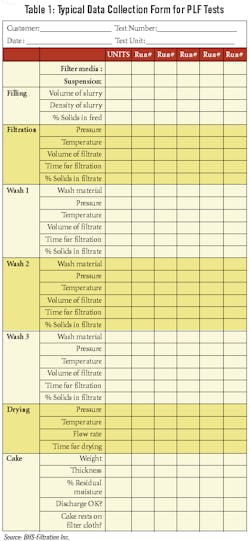

Required data and data collection. The testing objectives could be to expand plant production, decrease cycle times, maximize wash efficiencies or achieve another goal. Table 1 shows a typical data collection form that can be used for bench-top testing with the PLF unit. Table 2 illustrates the data about the process that are required, slurry, washing media and, most importantly, the testing objectives.
