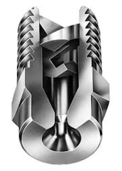

This cutaway illustrates an axial full-cone nozzle design, which uses a typical "X" style swirl insert.
Full cones
Trying to determine the free passage of a full-cone nozzle can be very difficult if the catalog does not spell it out specifically. Many designs are available, and little consistency exists between manufacturers.
Most full cones are axial designs and employ some kind of vane (spinner, swirl insert), which spins the liquid within the nozzle body. The centrifugal force of the spinning throws the liquid into a cone as it exits the orifice. Some helix (pigtail, spiral) designs use a long deflector surface to peel away the water column and form it into a cone. A few tangential inlet nozzles use that method to induce the spinning.
With standard axial designs, the vane generally is the smallest cross section. The nozzle will clog there before it will clog at the orifice. Consequently, nozzle designers strive to create a vane that has as large a free passage as the orifice. Such designs are available; however, an inverse relationship exists between free passage and the uniformity of distribution. Designs that boast high free passage measurements generally do poorly on uniformity.
The most extreme example of these phenomena is a helix design. Although helix designs rightfully claim high free passage, they do not create true full-cone distribution. They generate two or three concentric rings of liquid.
Other designs can have heavy centers or heavy edges, depending on the design approach. However, sometimes clog resistance is more important than distribution uniformity. If you need information about distribution, you will have to ask for it.
For small nozzles (generally less than 11/2-in. to 2-in. pipe connection), one of the best compromises is the "X" vane design. This design is available from several manufacturers and combines decent free passage with very good distribution. The design is available in a wide variety of angles and capacities so specific performance should be readily attainable.
If you are willing to make some design adjustments, tangential inlet full cones are available that offer excellent free passage and distribution combinations. The down side is the inlet configuration, which makes the cones hard to use with existing headers. They also tend to be expensive, and the capacity range is limited. However, if you can find what you want and make it work, it can be well worth the effort.
The key to full cone design is understanding what is ," and what is not ," the free passage measurement. Most of the time, it is not the final orifice diameter. If you are not sure and it is critical for your application, do not be shy about asking. The same goes for distribution uniformity.
