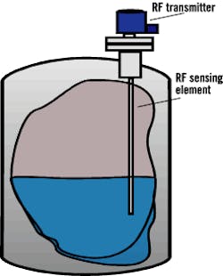

RF Capacitance Device

Capacitance/RF devices (point level or continuous)
. RF admittance is by far the most versatile level measurement technology, good for a wide range of conditions, from cryogenics to high-temperature and from vacuum to 10,000-pounds-per-square-inch (psi) pressure. It works with virtually all types of materials.
RF current from constant voltage applied to one electrode measures the impedance change between two capacitor electrodes (often a single electrode and the vessel wall, or the material itself and the insulating coating on the sensor), based on rise and fall of material in vessel. A second sensor to monitor dielectric can provide compensation.
RF devices feature excellent performance with thin fluids and for measuring interfaces, and perform fairly well to excellent in thick fluids and slurries. They can ignore organic foam, but can measure both aqueous and organic foams.
Switches generally are very good for powdery, chunky or sticky solids, but continuous measurement versions are more limited in this area. Continuous measurement versions also cannot measure the interface between conductive layers or between liquids and solids. With point level switches, conductive coatings can produce a false high without a guard-type probe, and short insertions can be a problem.

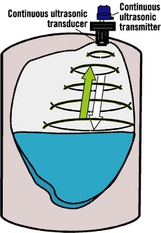

Continuous Ultrasonic Device

Ultrasonic (non-contact) devices
. Ultrasonic gap switches have one crystal electrically resonating at a certain frequency that generates sound waves. The sound waves travel across air gap toward the second crystal. As material fills the gap, the sound has a better medium to travel, causing a second crystal to resonate with the first. The continuous version sends a very high-frequency sound wave from a transmitter to the contents of the vessel and measures the length of time it takes for that signal to return to the transducer.
Ultrasonic devices perform excellently with thin fluids and ignore foam. Continuous measurement versions are fair choices for thick fluids, but switches are limited in that application. With continuous measurement versions, dust and dew in the vapor space hurt performance, and the range is limited by foam and angled or aerated solids. With switches, air bubbles and solid particles in the liquid will produce a "low" signal.
