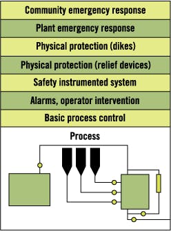

Multiple safety layers
One common theme in all of the industry's process safety documents is multiple independent protection layers. Instrumentation and controls form many of these layers. See Fig. 1.
Figure 1. Independent Protection Layers
Historically, all of the layers were independent, typically using diverse technologies from diverse vendors. However, with the acceptance of software programmable systems, many plant engineers have considered combining multiple functions into one system. For example, it is possible to combine control, alarms, shutdown and fire and gas systems in a modern DCS.
The benefits seem obvious ," single source of supply, simplified training and spare parts, lower installed costs, etc. ," yet all industry standards either outright forbid or strongly frown on such practices. The reasons are simple. How do you allow access to some functions, but deny access to others? How do you enforce management-of-change policies when operators are constantly making changes to the control system? How can you be certain changes made in one program area will not impact the functionality somewhere else?
