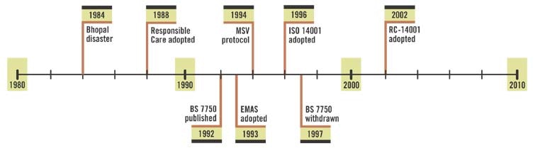

The rollout of the first elements of the Responsible Care initiative began 10 years before the advent of ISO 14001. Although the initiative started as a targeted program to avoid catastrophes such as Bhopal, it gradually evolved and grew in scope.
Over the years, the Responsible Care initiative has expanded to encompass an imposing range of issues such as health and safety, product stewardship and community relations. By 1998, the initiative even included an independent certification process of its own, known as Management Systems Verification (MSV).

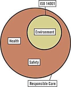

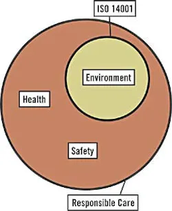

The Responsible Care initiative and ISO 14001 actually have different strengths. ISO 14001 focuses narrowly on environmental management and emphasizes rigor in certification. The Responsible Care initiative encompasses health, safety, community, customers and communication improvements. By combining the two, companies get a rigorous, broad standard that can yield outstanding performance.
Under RC-14001, an organization can build a single environmental, health and safety (EH&S) management system that is simultaneously consistent with both standards, while providing customers and other stakeholders with a greater level of assurance about its operations. To aid firms interested in pursuing this new integrated standard, ACC created the RC-14001 Management System Technical Specification, which systematically reconciles each element of ISO 14001 with the corresponding specifications of the Responsible Care initiative. It resolves each "discrepancy" in favor of the stricter requirement. As a result, RC-14001 offers several distinct requirements over ISO 14001 alone, including:
