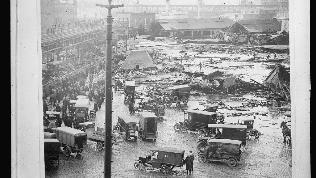

The previous day, a 50-foot-tall storage tank containing fermenting molasses ruptured, releasing 2.3 million gallons of syrup. According to a report from the U.S. Census Bureau, a 40-foot-high wave of molasses weighing 26 million pounds (13,000 tons) and moving at 56 km/hr flattened pretty much everything in its path and flushed victims into Boston Harbor.

First, the tank was constructed using the wrong alloy and gauge of steel. Leakage tests, routinely carried out by filling such vessels to capacity with water, were never performed before the tank was commissioned. Supervisors and inspecting officials responsible for the tank’s construction also did not have the required engineering expertise.
According to locals, the tank leaked from the start and reddish-brown stains from escaping molasses appeared on its blue paint job. Some reported collecting molasses from leaking rivets and seams for their own use. Others handed in pieces of metal to USIA that were thought to have sloughed off the tank.
The company’s response was to paint the tank brown to disguise leaking joints.
For the four years it was in operation, residents in Boston’s North End neighborhood grew used to the almost constant groaning coming from the tank’s joints.
The tank finally succumbed to physics on Jan.15 after a 600,000-gallon delivery of molasses pumped from a ship in Boston Harbor took it to capacity.
The familiar groaning became a roar as the steel walls tore apart, and a tsunami of syrup engulfed the local area.
The final death toll reached 21, and 150 injuries were reported. The body of the last victim wasn’t recovered for another four months, and clean-up crews spent an estimated 87,000 hours removing the sticky syrup from streets, trains and remaining buildings. They also had to tackle horses, pedestrians and gawkers who had trodden it all over the city. For decades, the air in that part of Boston was sweetened with the odor of molasses on warm days.

However, after six years of litigation, the Massachusetts Superior Court concluded the tank’s construction had been deficient. USIA was ordered to pay the victims’ families roughly $7,000 each. The $1-million total would be worth just over $18 million today.
Over the next 105 years, various theories have evolved to explain exactly what went wrong. These include a fermentation process causing a build-up of carbon dioxide inside the tank that burst rivets from the holes that lacked the necessary reinforcements, and thermal shock caused by convective mixing between warm and cold molasses in the tank just prior to its expiration.
