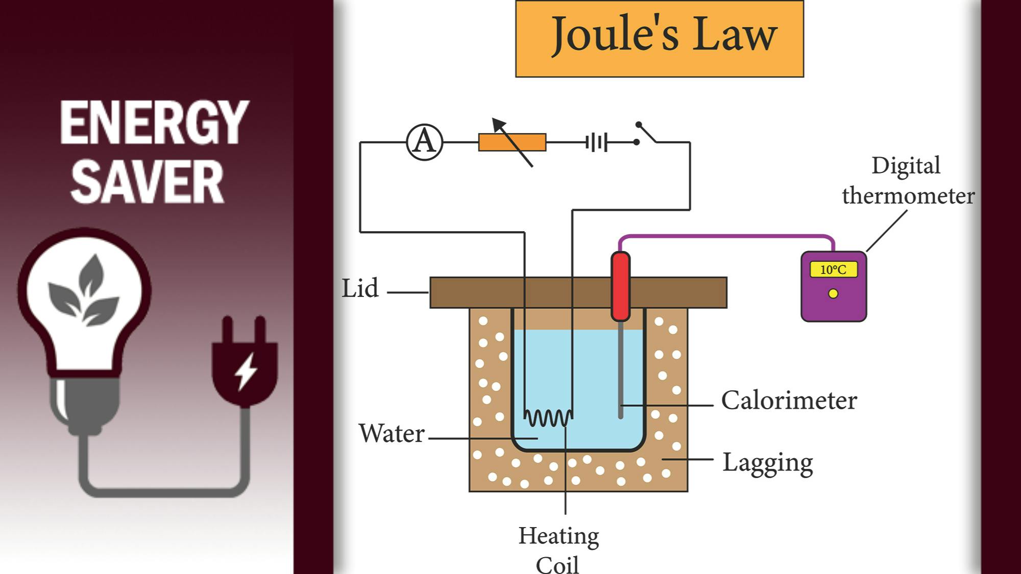

Ohmic heating operates on a straightforward electrical principle: when alternating current passes through a conductive material, the electrical resistance generates heat directly within the material itself. Unlike conventional heating methods that transfer thermal energy from external surfaces through conduction or convection, ohmic heating generates heat volumetrically throughout the entire material.
Specifically, Joule’s Law governs ohmic heating, where heat generation (Q) is proportional to the square of the electrical current (I), material resistance (R) and time (t):
Q = I2 R t
This fundamental difference in heat generation mechanism creates several distinct advantages over conventional heating technologies. This direct energy conversion eliminates intermediate heat transfer steps, enabling volumetric heating that uniformly raises the temperature of electrically conductive materials.
