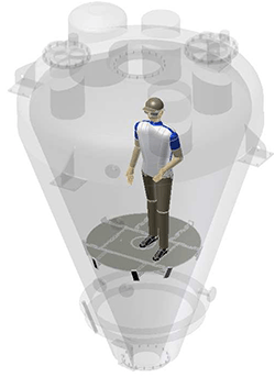

Working platforms can be installed inside almost all conical process vessels.
Heinkel’s modular and individually designable working platform is easily installed inside almost all conical process vessels including reactors, Nauta style mixer/dryers and single shaft dryers and mixers, according to the company.
Essential features of the working platform reportedly include:
  • Stable aluminum construction
  • Fast and easy installation
  • Modular design allowing installation via manway or other vessel nozzles
  • Low weight - each module less than 70 pounds
  • Easy handling requiring only a few bolts have to be fixed for a safe installation of the platform
  • Rubber pads to protect the vessel’s wall surface
  • Rescue hatches (or other requested openings possible)
