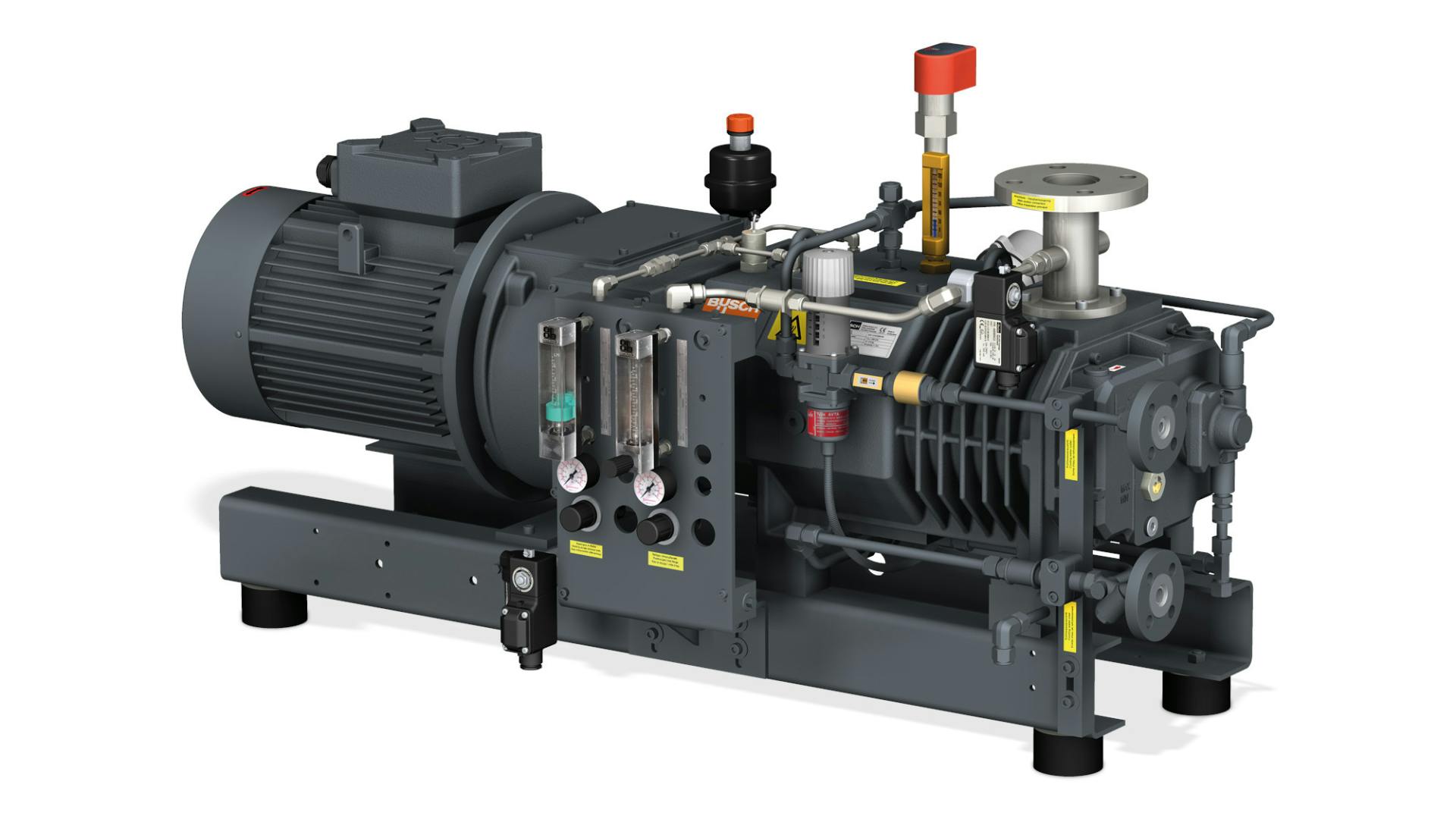

A. Dry vacuum pumps are versatile. You can manipulate them to do almost anything. There are several technologies available for dry vacuum pumps. For this conversation, I’ll just focus on vacuum pumps using a screw mechanism because I believe that is one of the best technologies out there — especially in the industrial large scale.
The advantage of a dry vacuum pump is the consistent performance. You have the same performance on day 1 as you do on day 100 because you don’t have any fluid that can capture the vapors or vanes that wear down. The vapors typically just pass right through the vacuum pump, as long as they stay in the vapor phase.
In contrast, an oil- or a fluid-sealed vacuum pump tends to trap the harmful gases, which you’re going to have to dispose of in the waste later. This will increase maintenance costs and be a potential health risk to employees. For a dry vacuum pump, the vapors that make it past some type of filter or trap upstream will pass through the vacuum pump and exhaust to atmosphere or an abatement system.
Another benefit of the dry vacuum pump is its very simple mechanism. There are only two rotating components inside of the vacuum pump. This results in lower maintenance and repair costs when compared to the other dry technologies. The screws are non-contacting, so the vacuum performance will not suffer with use. (Oil-sealed vacuum pumps usually have a vane or piston that contacts the sidewalls and eventually wears down. That means maintenance, which leads to parts and labor costs.)
The vibration levels for our dry vacuum pumps are much lower than a piston-style oil-sealed vacuum pump. This can be important for certain processes and instruments that are sensitive to vibration. Dry vacuum pumps cover a wide range of pressures from atmosphere to below 1×10-2 Torr. Compare this to an industry staple, the liquid-ring vacuum pump, which is limited to 25 Torr with water as a seal fluid; so, you can see there is more flexibility.
As for limitations, sometimes the upfront cost does not seem justified or there is a technology that is better suited for the application. If you’re operating in a higher pressure range — above 100 Torr — and you’re dealing with a concentrated vapor stream, it may be better to use a liquid-ring vacuum pump. Some processes in which sticky materials make it into the vacuum equipment, an oil sealed vacuum pump like our HUCKEPACK will be simpler to use. We work around these limitations with the use of different traps, flushes, and automation, but it’s an inherent advantage that sometimes the oil-sealed vacuum pumps will have.
In terms of cost, the prices have come down since we developed the first screw vacuum pump in 1991, but now it’s only a difference of maybe 20% more for a dry vacuum pump.

A. One of the most important considerations I would say for a dry vacuum pump is startup and shutdown. In most of the manuals, startup and shutdown is the same for wet vacuum pumps, but people don’t follow it and it’s not as crucial. But it is extremely crucial in dry vacuum pumps. You want to make sure you allow the equipment to warm up so that the design tolerances of the screw mechanism are optimum. It usually takes 10 minutes and then the vacuum pump is ready to go.
The shutdown is even more crucial. You want to make sure you follow what the manual recommends for shutdown such as isolating the vacuum pump and purging the swept volume with nitrogen or clean dry air of any condensable vapors, typically for 20–30 minutes. If condensable vapor remain inside the vacuum pump, the metal material of construction will begin to erode. Even though we offer protective coatings on our screws, proper shutdown procedure is necessary.
Additionally, we recommend you have a power failure mode. A normally closed inlet isolation valve and a normally open purge valve just below it should help to protect the vacuum pump. This equipment protection feature isn’t implemented by a surprising number of plants.
It is important to protect your investment by having filters or traps in front of the dry vacuum pump. While they can take slugs of liquid, it’s always important for any technology to have a knock-out pot if this is a possibility. Typically, a dry vacuum pump can ingest a liter or so of liquid without it be-ing an issue, but you don’t want to send 20 gallons to it. Any vacuum pump is going to have a hard time with that. We can use this ability to ingest liquids and do a solvent flush to clean the swept volume. For the most efficient cleaning, you should slow the vacuum pump down with a VFD and then draw in the solvent of choice. This allows you to remove all of the gummy material from the screws.

A. There aren’t any necessarily unique to dry vacuum pumps versus wet vacuum pumps. You want to eliminate as much pipework as possible because you want to limit conductance loss through bends and long pipe runs. And then, you want to make sure your exhaust is clean and clear because vacuum pumps, in general, don’t like having too much back pressure. Check valves are recommended to prevent reverse rotation and contamination from exhaust pipework, especially when multiple exhausts are connected to the same header.
With dry vacuum pumps, if you exceed the back pressure limit, this will cause undue stress on the motor and elevated internal temperatures. The increased temperature leads to excess metal expansion and, ultimately, the seizure of the vacuum pump. Our design is more tolerant than most. Typically, the industry average is around 2 psi for continuous use. Ours is at 3 psi, which doesn’t sound that significant but is — we have some room to give, especially with people who are trying to push their process to an abatement system that can provide some back pressure.
