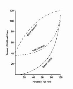

Multiple vanes upstream of the fan wheel inlet provide it with a controlled presentation of air that enables smooth control over a wide range of operation. Inlet dampers create a new fan performance curve for every damper position, losing efficiency as airflow rates decrease (Figure 1).
Figure 1 -- Fan performance curves: A VFD provides markedly higher energy efficiency when airflow is reduced significantly.

If an air movement system is infrequently used, inlet dampers may come out on top in an initial-cost/potential-energy-savings comparison of airflow regulation devices. They are especially effective when restricting airflow by less than 20%.
Some caution is in order when dampers severely limit airflow. Restricting airflow by as much as 70% may lead to flow instability or rotating stall, i.e., air starvation resulting in high-amplitude pressure pulses. Take the recent case of a steel mill operating coke-oven-battery scrubber fans with inlet dampers 90% closed. Fan professionals documented severe vibration and cracking of fan casings. Measurements of vibration, pressure pulsation and frequency confirmed a rotating stall condition. After installing a VFD, the mill could leave the damper fully open and regulate airflow by adjusting the fan speed. The fan then smoothly operated at all process flow rates. The mill realized energy savings estimated at more than $250,000 annually.

These control flow by restricting the airstream’s path at the outlet. They are rarely used on large industrial fans due to their poor efficiencies (Figure 1) and potential to damage system components.
Partially closing, or throttling, parallel or opposed damper blades provides the desired reduction of flow. However, pressure increases on the upstream side of the dampers boost backpressure on the system. This resistance causes the fan’s operating point to shift negatively on its performance curve.

As the fan speed (rpm) decreases with VFDs, the pressure, volume and horsepower all decline. The curves for both fan performance and brake horsepower (BHP) move essentially in harmony with the fan law curve (Figure 1). This shift works well for most fixed-resistance systems. It offers significant horsepower savings at reduced speeds, as shown by the third Fan Law: BHP2 = (rpm2/rpm1)3(BHP1)
In other words, halving a motor’s speed will reduce power consumption to one-eighth. For example, a drop from 1,000 rpm at 1,000 BHP to 500 rpm results in a power reduction to 125 BHP. Much less energy is needed to run the motor at the lower speed.

Only one point exists at which the power efficiencies for inlet dampers, outlet dampers and VFDs are essentially the same — maximum speed. With maximum flow, power consumption is relatively similar for all three options. As flow demand decreases, VFDs typically offer the best efficiency. However, inlet dampers may be a viable alternative if system flow demands remain consistently in the 80%–100% range. For most systems, outlet dampers aren’t a viable means of flow control. Remember, though, choosing the best flow regulation device for an operation demands careful analysis.
