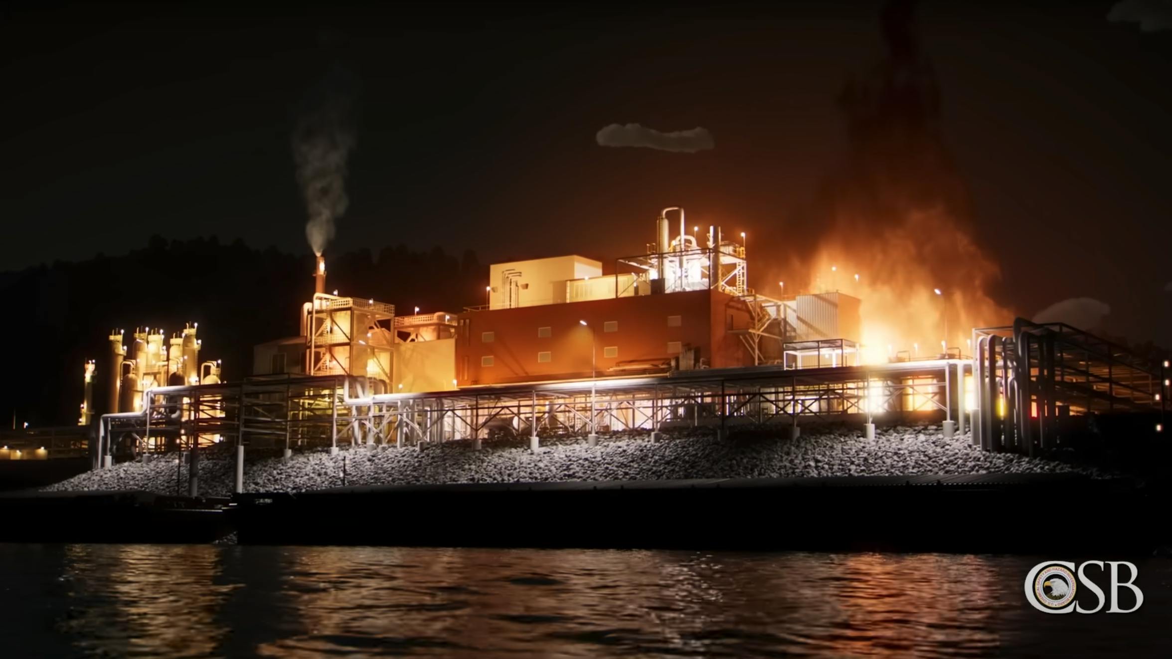

The U.S. Chemical Safety and Hazard Investigation Board (CSB) released a new safety video May 22 detailing findings from its investigation into a fatal 2020 explosion at the Optima Belle facility in Belle, West Virginia.
The incident killed one worker, injured several others and prompted a shelter-in-place order for residents within a two-mile radius. Property damage was estimated at $33.1 million.
Titled “Outsourcing Responsibility: Explosion at Optima Belle,” the video includes animation of the events leading to the explosion and features commentary from a CSB board member and investigators.
Optima Belle is a toll manufacturer that provides chemical processing services under contract to other companies, typically using its own equipment. On Dec. 8, 2020, the company was dehydrating a reactive chemical called CDB-56 for Clearon Corporation using a rotary double cone dryer. Neither company had used this type of pressurized dryer for the substance before, said the CSB in a press statement.
CSB found that Clearon did not provide Optima Belle with sufficient information about the chemical’s properties, and neither company conducted a thermal hazard assessment. As a result, they did not anticipate that CDB-56 could decompose at lower-than-expected temperatures, leading to a pressure build-up that caused the dryer to explode, according to the statement.
CSB released its final report in July 20233. The video highlights five key issues identified in the investigation: process knowledge management, thermal hazard assessment, equipment selection and design, tolling of hazardous materials and regulatory coverage of reactive hazards. It also outlines recommendations made to Optima Belle, Clearon, the Occupational Safety and Health Administration (OSHA) and the Environmental Protection Agency (EPA).
