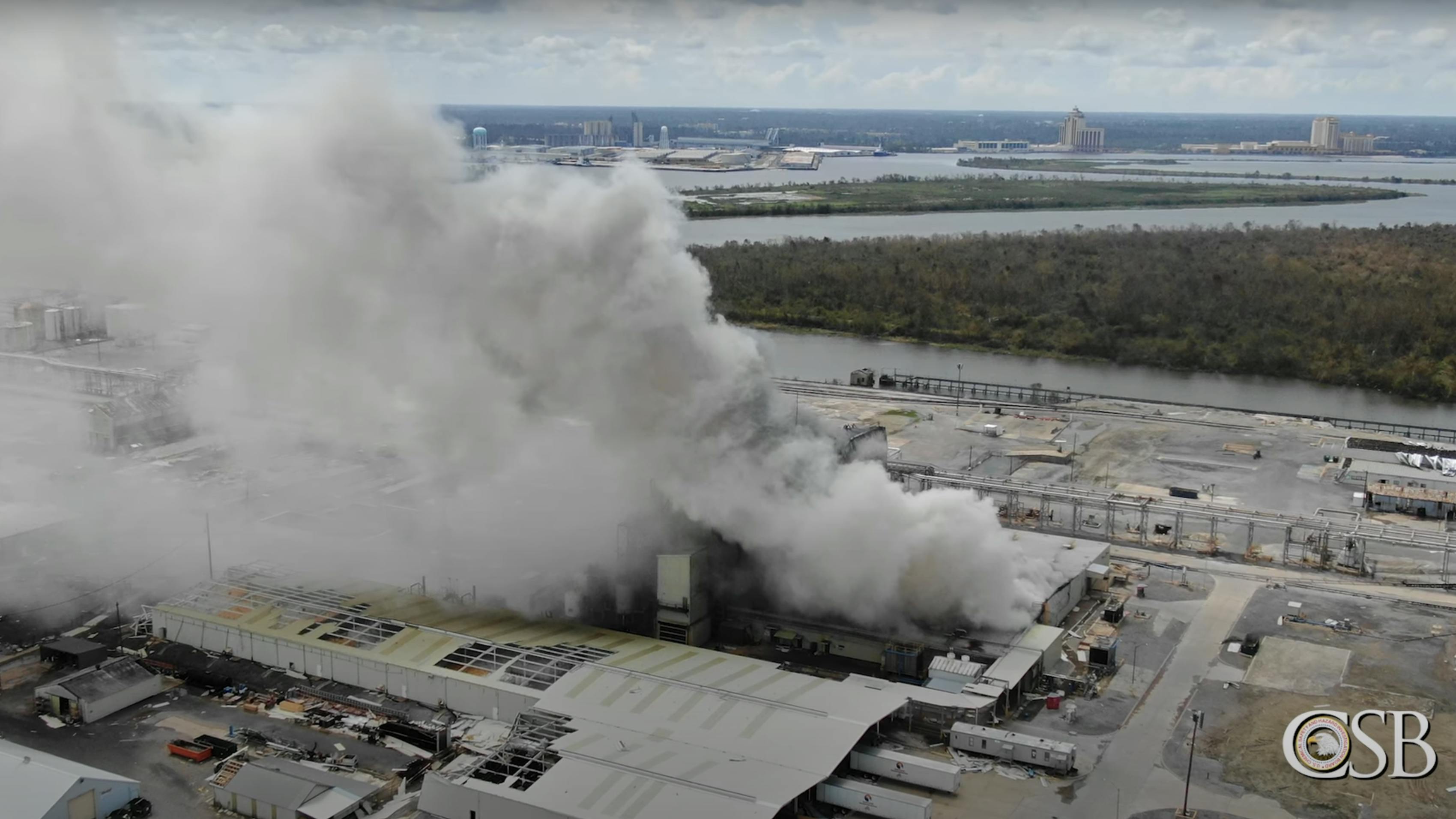

The U.S. Chemical Safety and Hazard Investigation Board (CSB) has released a new safety video on its investigation into the August 2020 fire and toxic gas release at the Bio-Lab Lake Charles chemical facility in Westlake, Louisiana, that occurred when the facility was severely damaged by Hurricane Laura.
The new safety video includes an animation of the events leading to the incident, and commentary from CSB board member Catherine Sandoval and investigator-in-charge Vonzella Vincent.
The Bio-Lab facility manufactures and supplies water treatment products for pools and spas, including a formulation comprised primarily of the chemical trichloroisocyanuric acid (TCCA). In large bodies of water, like swimming pools, TCCA-based formulations dissolve and break down slowly, releasing available chlorine into the water to sanitize contaminants, such as algae and bacteria.
However, when a TCCA-based formulation interacts with a small amount of water and doesn’t dissolve, a chemical reaction can occur, generating heat and causing the material to decompose and produce toxic chlorine gas.
The CSB’s investigation found that as Category 4 Hurricane Laura approached, Bio-Lab took steps to remove chemical products from the facility via trucks. However, some trucks never arrived, leaving more than 1 million pounds of the TCCA-based formulation and other chemicals on-site ahead of the storm. Extreme wind from Hurricane Laura severely damaged buildings at the facility, allowing rainwater to seep in and come in contact with the products stored inside. The stored chemicals reacted and decomposed, igniting a fire. A large plume of hazardous gases, including toxic chlorine, spread over the neighboring community leading to a shelter-in-place order.
