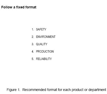

The meeting should begin with a review of the previous shift for each product, or department. This is the tactical section of the meeting. It is best to follow the same outline for each meeting. Begin this segment with a summary of each product or department, with topics in order of importance: safety, environment, quality, production, and reliability. Unlike the handover meeting, the shift meeting should address more details of a strategic nature.

As with the handover meetings, items requiring detailed discussions should be held in a later sidebar meeting. If possible, for a complex production facility, it is best to summarize each product, briefly, by subject: safety, environment, quality, production and reliability — leave the details for a separate meeting. It is especially important that minutes be prepared for the shift team meetings. Whenever possible, these minutes should be widely shared within the facility (Figure 2).
