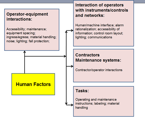

Figure 1. Human factors play an important role in ensuring safety in disparate plant activities.
Figure 1 depicts human factors from a systems’ viewpoint and highlights the four key aspects: operator/equipment interactions; operator interactions with instruments/controls and networks; contractor interactions; and tasks. It also notes specific factors that can impact safety in the event of an error. The bottom-line during design is to match systems with average human capabilities. To enhance the effectiveness of human factors assessment, consider eight key points.
