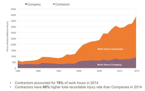

Many chemical makers increasingly rely on contractors to supplement their in-house workforces. Indeed, at some sites, contractors likely make up a majority of the workforce. Pointing up the general trend, “Safety Performance Indicators — 2014 Data,” published in June by the International Association of Oil and Gas Producers, London, a trade group focused on upstream activities, indicates that contractors accounted for 78% of its members’ total workforce hours in 2014 versus about 50% in 1995 (Figure 1).
Greater Use of Contractors
Figure 1. Global data show the increasing role played by contractors. Source: “Safety Performance Indicators — 2014 Data,” International Association of Oil and Gas Producers.
