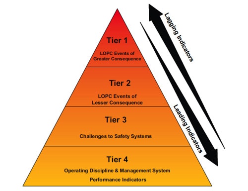

Process Safety Hierarchy
Figure 1. Incidents fall into four tiers, topped by highest impact, lowest frequency events. Note: LOPC = loss of primary containment.
