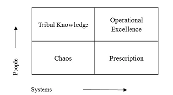

Common characteristics used to describe management systems include a combination of people and systems, as illustrated in Figure 1.
Operational Excellence Model
Figure 1. People and systems both play key roles in achieving success.
Weak systems executed by weak people lead to chaos. Strong people can provide a strong management system. However, if that system isn’t documented, the organization will lose knowledge when people leave. Similarly, a management system only made up of procedures either leads to people blindly following them without critical thinking, or ignoring the procedures. An effective management system requires knowledgeable people executing the necessary process safety elements with discipline to produce repeatable results. This type of system leads to operational excellence and continuous improvement.
