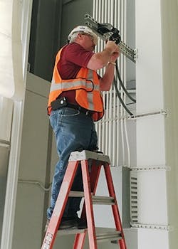

Flame Detector Installation
Figure 2. Proper placement requires avoiding obstructions between detectors and the area of interest.
In addition, you can performance test a flame detector with the fire type to determine its effective detection range. Flame performance testing also can ascertain a detector’s coverage area or field of view (FOV). In most cases, the greater a detector’s range and FOV, the fewer devices a plant will need to achieve the necessary coverage. As with gas detectors, optical flame detectors require a clear line of sight to the area being protected, so proper placement, i.e., with no obstructions between detectors and the area of interest, is critical (Figure 2).
Because non-fire sources as well as fire emit UV and IR energy, it’s important that flame detection systems don’t misinterpret non-hazardous situations and set off costly false alarms. IR and MSIR detectors typically differentiate fire from non-fire sources by using optical filters and algorithms that analyze the characteristics of the IR energy detected. In most cases, such analysis can successfully identify non-fire IR sources. However, if an object or person moves between the non-fire IR source and the detector, the randomly modulated IR energy produced could mimic a fire signal.
To optimize a flame detector’s false-alarm-rejection performance, you should limit a detector’s FOV to the area that requires flame monitoring. In addition, controlling the detector’s FOV by careful installation and aiming will enhance performance. You also can consult the manufacturer for information about detector configurations that can help mitigate the effects of background IR sources.
An easy way to reduce false alarms is to remove sources of intense IR emissions, such as hot objects including fin-fan heat exchangers and hot pipes, from a flame detector’s FOV. When this isn’t possible, you should inhibit the operation of a flame detector that has an intense IR source within its FOV before personnel begin working near the detector.
Another way to minimize false alarms is to use multiple devices to monitor the same area to validate flame detection. This type of system must include algorithms capable of handling “voting” circuits (with each detector’s interpretation of an event counting as one vote) and making correct decisions based on input from multiple detectors.
