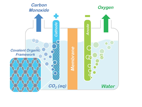

COF Catalyst
Figure 1. Conceptual model shows how porphyrin COFs could be used to split CO2 into CO and oxygen. Source: Omar Yaghi, UC Berkeley.
“A key feature of COFs is the ability to modify chemically active sites at will with molecular-level control by tuning the building blocks constituting a COF’s framework,” Yaghi explains. “This affords a significant advantage over other solid-state catalysts where tuning the catalytic properties with that level of rational design remains a major challenge. Because the porphyrin COFs are stable in water, they can operate in aqueous electrolyte with high selectivity over competing water reduction reactions, an essential requirement for working with flue gas emissions.”
Results show high catalytic activity — the porphyrin COF has 26 times greater catalytic activity than a molecular cobalt porphyrin catalyst, making it one of the fastest and most efficient catalysts for carbon dioxide reduction, the researchers report. One porphyrin COF can reduce 290,000 molecules of carbon dioxide to carbon monoxide every second. A recent article in Science describes the research in detail.
