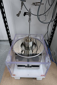

Figure 1. Reaction takes place at a lower temperature than needed by other plastics conversion processes. Source: Osaka City University.

The researchers carried out the hydrogenolysis reaction in a 190-mL stainless steel autoclave pressurized to 6 MPa with hydrogen (Figure 1). They ran trials with various polyolefins, including low-density polyethylene, high-density polyethylene and polypropylene. Yields of valuable chemicals ranged from 83–92%.
