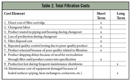

Filter versus filtration cost
The expense of a filter is only part of the overall operating cost for filtration [5]. Table 2 lists typical expenses, including the cost of the filter, plus a number of other important items.
Items 1 through 8 in the table cover a variety of filtration costs that are incurred short term, around the time the filters are placed in service. These are relatively easy to identify among a plant's operating expenses. Items 9 and 10 are costs that only become evident after a longer term, often many months later. They can markedly exceed the short-term costs but are not as easily identified among total plant expenses. The important point is that direct filter cost is only a part of total filtration cost.
Consider the case summarized in Table 3, which compares low-cost filter A to a more expensive but better-performing filter B. The table shows typical parameters describing the total filtration cost for each case. Filter B clearly offers significant cost savings even without taking Items 6-10 from Table 2 into account. These items are too case-specific to include in this example; their effect, however, would be to increase the savings realized by using the "more expensive" filter.
