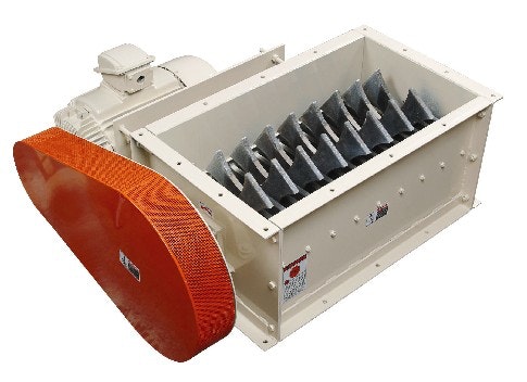

Impact mills use revolving hammers to strike incoming particles and to break or fling them against the machine case (Figure 1). The hammers might be fixed or, more commonly, pivoted. Typically, the hammers can be reversed to provide added life before they need to be replaced.
Figure 1
