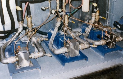

Lobe pumps are not available in seal-less designs. All require two shaft seals; some types with bearings external to the liquid need four. Industrial lobe pumps offer at least as many sealing solutions as other rotary or centrifugal pumps —including packed glands, cartridge-style single or double mechanical or triple lip seals (Figure 4), and component-type single or double mechanical seals (Figure 5). API seal plans are available. So, if a specific brand or type of seal works well in your problem applications, it often can be applied to an industrial lobe pump. For sanitary lobe pumps in industrial applications, seal options include packing, O-ring seals, lip seals and component-type single and double mechanical seals, but standard cartridge seals are not an option.
Cartridge_style seal
Figure 4. This pump features cartridge-style triple lip seals and bushings on both sides of rotors. Component-style seal
Figure 5. These pumps employ component-style double mechanical seals with seal flush.
