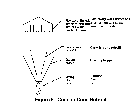

Hopper retrofits. If a hopper does not produce flow at the hopper walls (commonly called mass flow), retrofitting the existing hopper can eliminate the source of flushing while improving segregation, process flow rates and feeder performance. Although a more expensive option, it is often the most reliable and cost-effective in the long run.
Retrofitting a conical bin outlet with a properly sized small hopper that produces flow along hopper walls or with a small cone-in-cone hopper (Figure 8) allows a high flow rate without flushing. The retrofit must be large enough to eliminate ratholes (flow channel greater than the critical rathole diameter) but small enough to prevent powder over-compaction in the flow channel.
