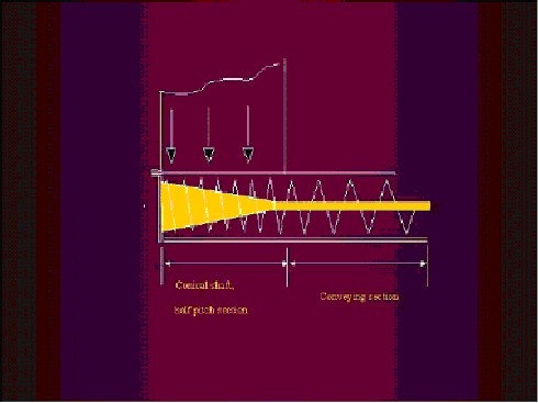

With belts, we design an interface to the belt as shown to provide the required increase in capacity (Figure 4).
Figure 4. A variable pitch or conical screw conveyor can provide even flow across the bin area.
