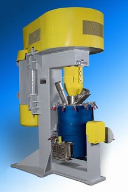

Specialized Mill
Figure 3. This unit was designed specifically for fine grinding of calcium carbonate.

Mills can be tailored to specific duties (Figure 3). Some feed materials pose special requirements. Those that easily oxidize must be milled under a blanket of an inert gas like argon or nitrogen. Materials such as plastics, etc., that aren't very friable require cryogenic milling (Figure 4). Sometimes this can be done by blanketing the material with liquid nitrogen; other times milling must be done in a liquid nitrogen slurry. When milling with solvents such as acetone that evaporate very easily, a water-cooled cover on the mill offers benefits.

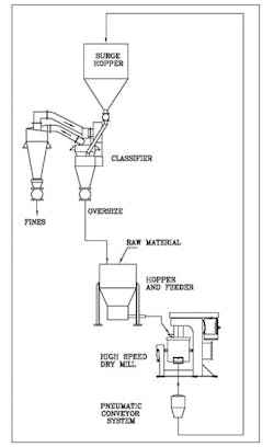

Closed Loop
Figure 5. Oversize material is separated and then returned to the mill.

Dry grind mills can be used in conjunction with air classifiers or screeners to form a closed grinding process loop (Figure 5). By continuously classifying out fines and returning oversize material to the mill, such systems can very efficiently provide sharp particle-size-distribution grinds.
As a rule of thumb, dry grinding generally will achieve particle sizes of 3–5 microns. To mill to sizes below that range requires wet milling. Today, the trend clearly is to produce nanoparticles.
