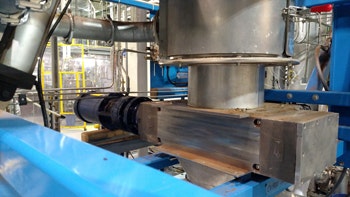

Our biomass inputs tend to agglomerate and form big chunks during shipment to the plant. Because our conversion equipment is sensitive to large, tough debris, we must break up these larger pieces of biomass in the early stages of the process before sending feed to slurrying tanks.
When we originally developed and implemented Plantrose technology several years ago, we purchased a lump breaker to handle the woody biomass and feedstock materials.
The lump breaker uses a once-through chopping action to crush material to facilitate mixing and conveying. However, wide gaps in the unit allowed biomass chunks to pass through into the feed system. This caused troublesome clogs in the process on a daily basis, and required operators to halt the operation for up to two hours each time to remove the offending clumps. These continuous stops and starts to the system drain energy and productivity, and cause undue stress and wear on the equipment.
After conducting research on available industrial waste-reduction products, we ultimately reached out to JWC Environmental, Costa Mesa, Calif., for more information on its Monster Industrial family of waste shredders and grinders. The variety of applications the shredders handled, including similar waste-to-energy endeavors, intrigued our engineering team.
A Better Solution
We opted for a Monster Industrial 3-Shred unit (Figure 1). The grinder comprises two rows of sharp steel cutters that rotate toward one another at low speed. The cutters are stacked in a helical pattern, so the teeth reach up and proactively grab material and pull it into the grinder for reliable size reduction. The unit also has much tighter tolerances than the lump breaker we had, so the wood chunks can’t bypass the cutter stack.
Customized Grinder
Figure 1. Unit features a slim, 13-tooth cutter configuration and took only a few days to install.
“JWC Environmental worked with us to design a unit that was perfect for our needs,” says David Biondo, our senior process engineer. The Monster Industrial team worked with him to incorporate several customized features including a slim, 13-tooth cutter configuration to ensure a fine particle output of the woody biomass to prevent clogs and maintain flow. “The grinder ensures the woody material comes out the way we need it to,” Biondo notes. “It cuts, squeezes and crushes the biomass chunks and they fall apart as soon as they hit [the] slurrying feed system. The woody material goes into the grinder looking like hockey puck chunks and comes out looking like Puppy Chow pieces.”
Total purchase cost of the unit was $25,000. We were responsible for its installation, which took place in the second quarter of 2015. This involved removing the old lump breaker, fabricating some transition pieces because the grinder and lump breaker weren’t the same size, and then installing the grinder. In all, the installation process only took a few days.
The 3-Shred has solved our feed problem. Now, we can focus on commercializing the Plantrose process and boosting our business rather than spending time on equipment downtime due to clogging.
