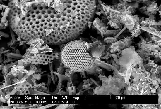

DIATOMITE
Figure 1. This material, Celite, is made of the microscopic silica skeletons of prehistoric plants. Source: Imerys Filtration Minerals Inc.
Diatomite. Also known as diatomaceous earth (DE), diatomite (Figure 1) consists of the microscopic silica skeletons of prehistoric plants. These skeletons are called diatoms. This material is mined and calcined to destroy any organic matter. The DE then is milled and separated into various filter aid grades via air flotation. The final product is a soft, powdery material resembling chalk.
Diatomite filter aids boast the advantage of a rigid and highly porous structure. When deposited on a filter medium, the DE forms a non-compressible cake and acts as a sieve to remove fine solids. The micropores in the diatoms allow flow through the particle while the fine solids are captured between the diatom granules. Being comprised mostly of silica, DE is inert in a wide range of applications.
